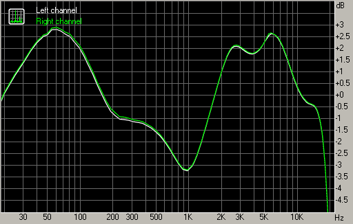

| Polarity | inverted/inverted |
| Frequency response (from 40 Hz to 15 kHz), dB | +2.82, -3.24 |

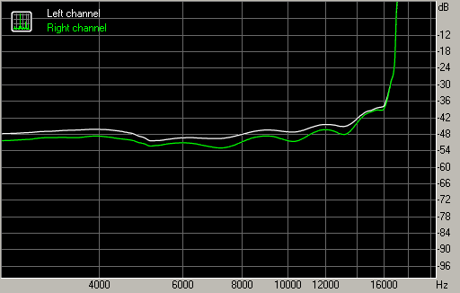

| THD + Noise, dB (A) | -51.9 |
Poor |
| IMD + Noise, % | 0.516 |
Poor |

| From 20 Hz to 20 kHz, dB | -6.75, +2.82 |
| From 40 Hz to 15 kHz, dB | -3.24, +2.82 |

| THD + Noise, % | +0.2110 |
+0.1845 |
| THD + Noise (A-weighted), % | +0.2703 |
+0.2363 |
